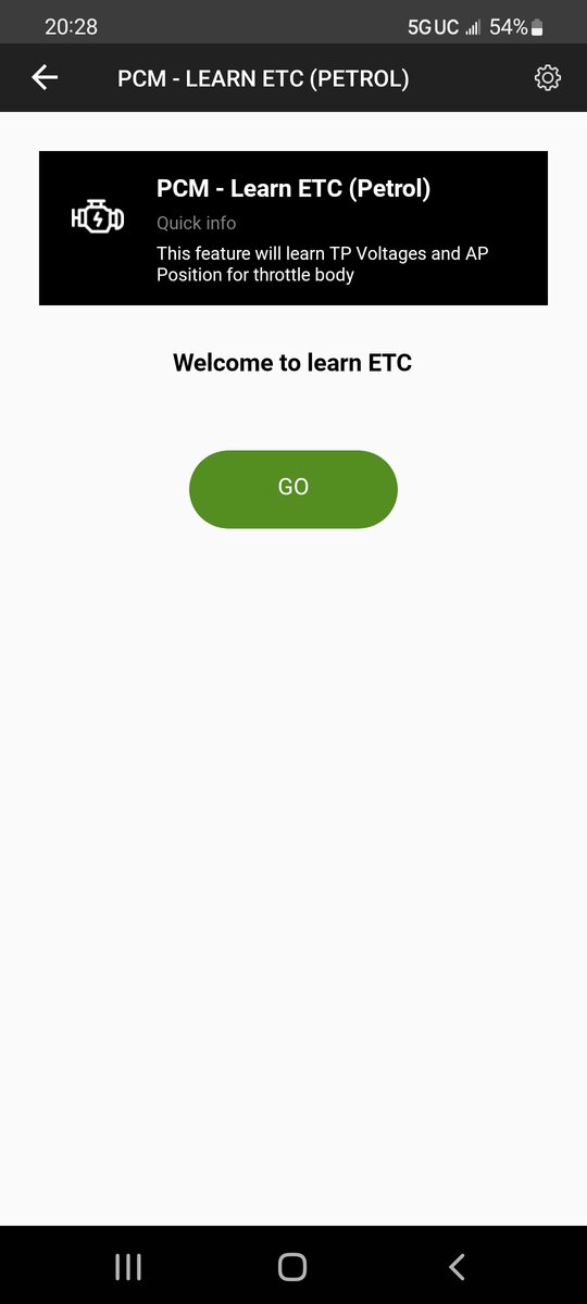

I found the option in jscan redid mine through the app
