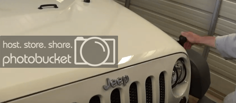

Step 1 – Open the hood and prop it in place
Before you can access any of the trim clips, you have to open the latches and prop the hood in place.

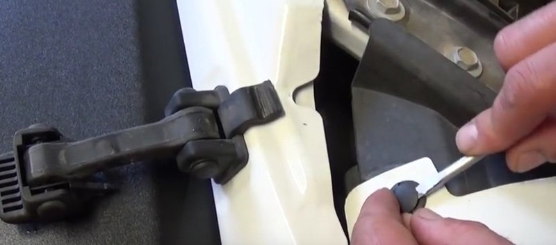

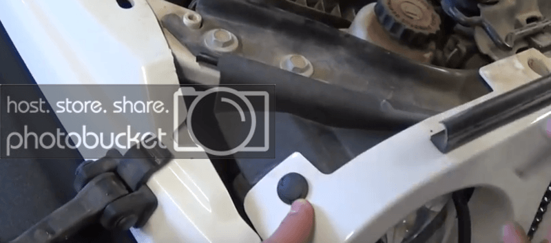

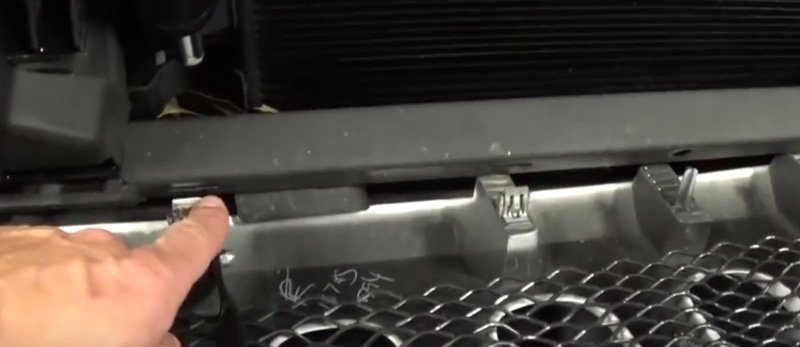

Step 2 – Remove the locking clips
When you look at the grille, you'll notice several locking clips in place that secure the grille to the Jeep. Use the flat head screwdriver to pop the center locks out and then remove the clip. Do this for all six clips.
Figure 2. Locate the locking clip for the grille.
Figure 3. Remove each clip.

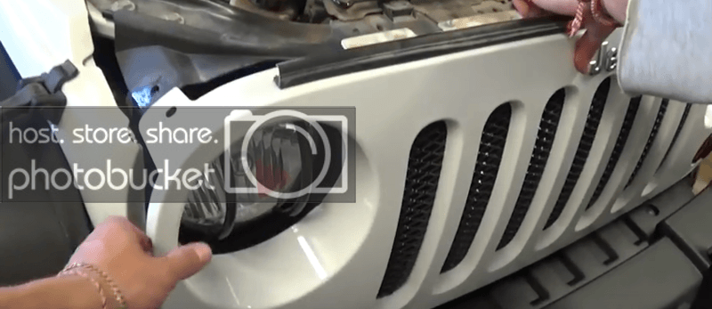

Step 3 – Remove the grille assembly
With the top clips off, grab the grille assembly and begin to pull it forwards. As you pull it down, the bottom clips will begin to pop out. Then, gently pull the grille cover outwards.
Figure 4. Remove the grille assembly from the Jeep.
Figure 5. Carefully remove the bottom section of the grille clips.

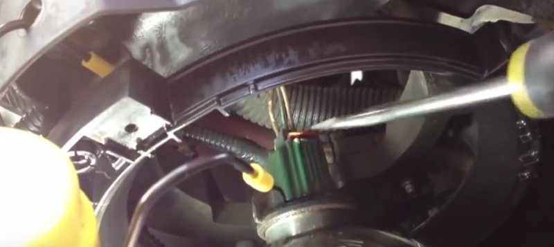

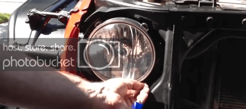

Step 4 – Remove the headlight housing
Use the T15 Torx driver to remove the four screws holding the headlight housing in place. Pull the housing out, disconnect the headlight bulb and replace the unit. Then reinstall the headlight assembly and grille.
Figure 6. Remove the headlight assembly.
Figure 7. Disconnect the headlight bulb and replace it.
