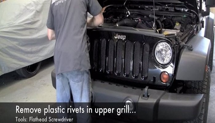

Step 1 – Remove grille
To access the connections and housing to the fog lights, the grille must be loosened and removed.
  • Use flat head screwdriver to push and remove plastic rivets on upper portion of the grille.
  • There are grille "clips" on both sides that you will need to pop out.
Figure 1. Remove upper grille rivets.

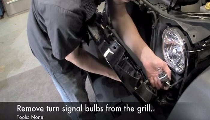

Figure 2. Pop the turn signal lights out.
Pro Tip
As you release the grille, you will find the turn signal bulbs hold them back. They can be disconnected at this time.

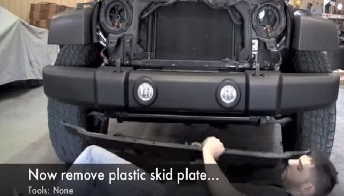

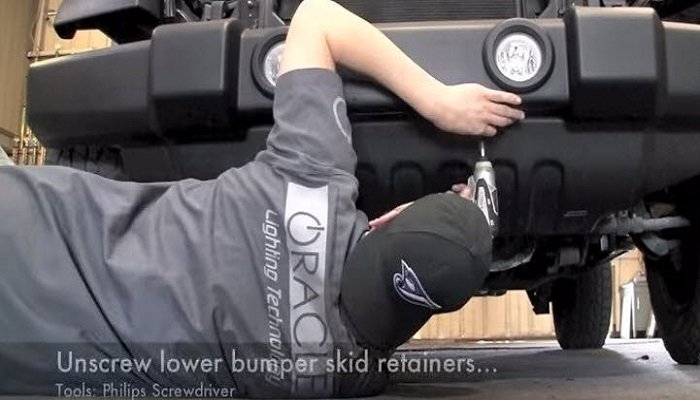

Step 2 – Remove lower bumper grille
To completely access the fog light for removal, the lower skid plate needs to be removed.
  • Unscrew two bolts from beneath the lower skid plate.
  • Remove the clips from behind skid plate.
  • Remove the skid plate as one unit.
Figure 3. Unscrew bumper skid plate.
Figure 4. Remove the skid plate.

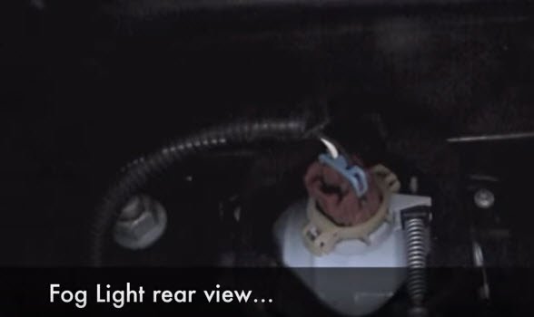

  • Unscrew the fog lights.
  • Turn that bulb counterclockwise to remove the bulb.
  • Replace the bulb.
Figure 5. The back of the fog light housing.
