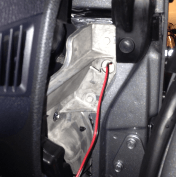

The 12 gauge wire is a good heavy duty wire that won't generate much heat for this load. The wire will be installed directly from the battery to the outlet, so take a look at the wire path from the battery to the location that you plan to install the outlet. In most cases, you will need to locate an entry point from the engine compartment through the firewall. Most vehicles have smaller access ports like the one shown in Figure 1.
Figure 1. Your access port through the firewall.

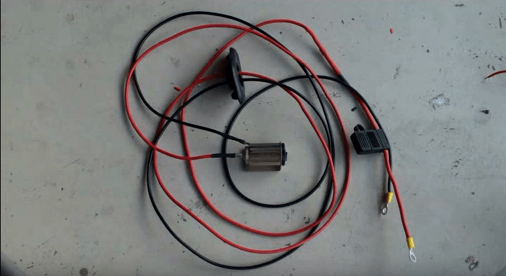

Now that we know the wire type and the path to the outlet, run the wire to determine the length you will need to cut. You will be cutting two identical lengths of wire: one red as well as one black for power and ground connections as shown in Figure 2.
Figure 2. Use black and red wires.

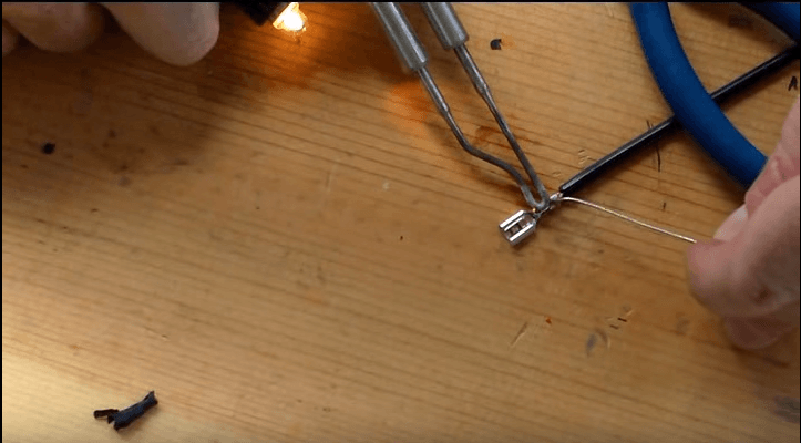

The accessory outlet most likely has a smaller gauge wire already connected to it. Remove those connectors and solder them to the larger gauge wire as shown in Figure 3. Use shrink wrap tubing to cover the connectors and protect them from dirt and moisture. Test to make sure the connectors slide on tightly to the terminals of the accessory outlet.
Figure 3. Solder connectors to larger gauge wire.

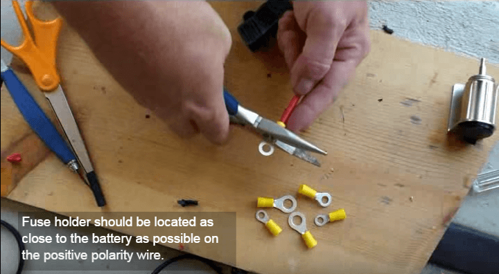

Next, solder the ring connectors to the other end of each wire and shrink tube those ends as well. These will connect directly to the battery terminals.
Finally, you will need to connect the inline fuse close to the positive terminal of the battery. Cut the wire about a foot from ring connector and solder one end of each wire to the inline fuse. Shrink tube both ends to complete the wire connections.
Figure 4. Solder ring connectors.

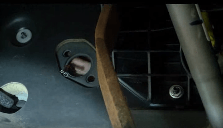

Feed the wire through the firewall and along the wire path to the battery as shown in Figure 5. Be sure to connect the outlet first, and keep both wires away from the battery terminals.
Figure 5. Feed wire through the firewall.

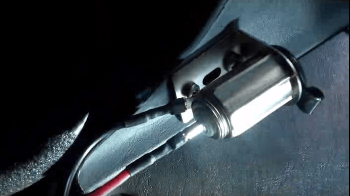

Connect the black ground wire to the outer post of the outlet, and then the red positive wire to the center of the outlet base as shown in Figure 6.
Figure 6. Connect black and red wires to accessory outlet first.

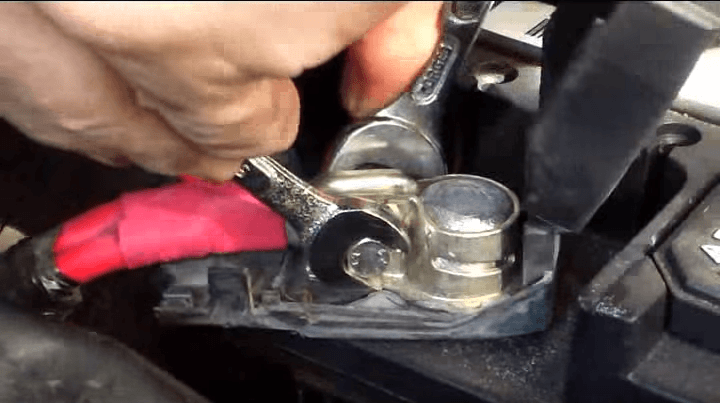

Now fasten the ring connector of the black wire to the negative battery terminal first, and then repeat the process for the red wire and the positive terminal as shown in Figure 7.
Figure 7. Fasten ring connectors to the battery.

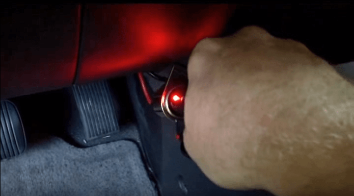

Step 5 – Test the outlet
The wiring is now complete.
Test the outlet by plugging in any 12v car accessory and verify that you have power.
Figure 8. Power accessory working!
