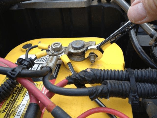

For safety purposes, disconnect the negative battery cable.

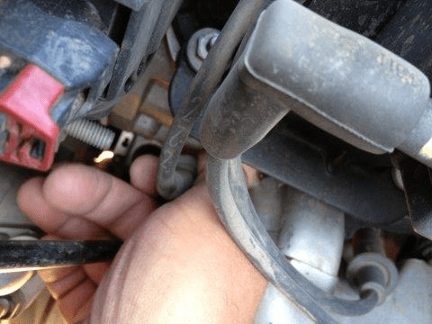

Remove cylinder #2 (drivers side front) spark plug wire. (You may need to twist the boot left and right to break it loose from the coil and spark plug)

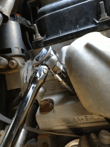

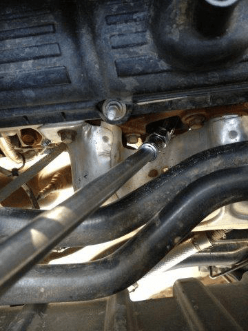

Using the 3/8” ratchet, extension, swivel and 5/8” spark plug socket, carefully remove the driver side front spark plug. (Note: Before removing the spark plug, take care to remove any debris that may have collected from around the base of the spark plug to prevent foreign objects from falling into the cylinder.

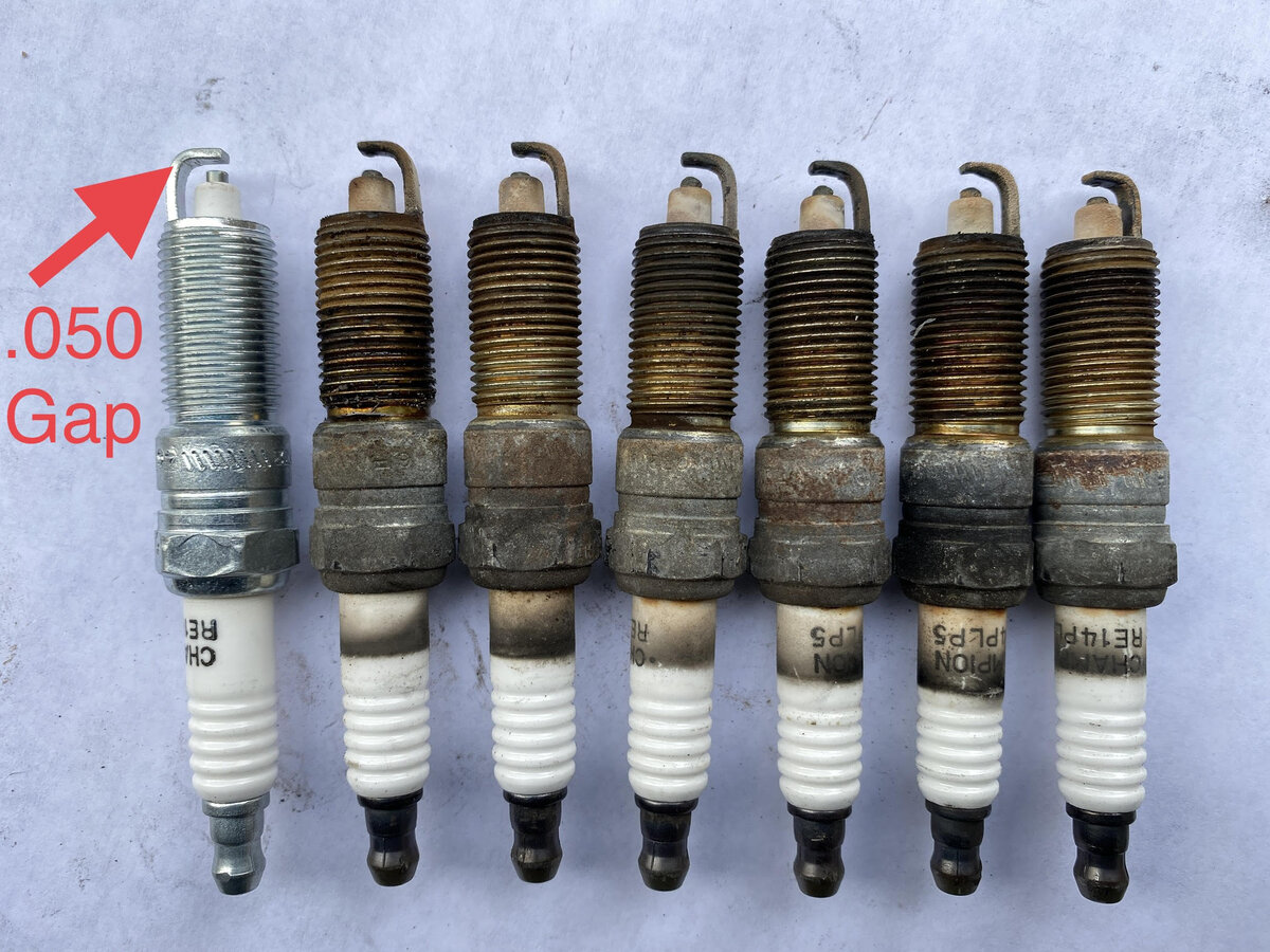

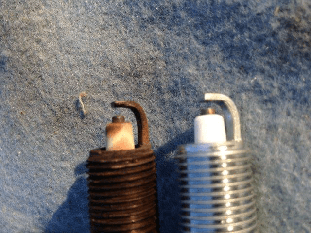

Here’s an old vs. new comparison of the spark plug. Due to wear and tear, you will notice the gap of the old plug has widened quite a bit compared to the new.

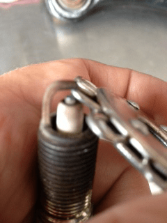

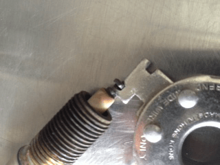

Using the spark plug gapper, find the .050 gauge feeler and carefully place it between the grounding electrode and center electrode. You should feel a slight drag as you slide the feeler between the gap. If adjustment is needed, use the adjustment slot on the gapper to bend the grounding electrode in or out. Use small movements and recheck the gap frequently. (Important: never pry against or bend the center electrode or damage to the spark plug will occur.)

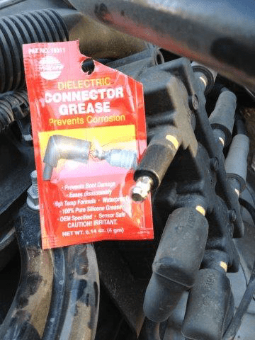

Add a small amount of Dielectric grease to the coil pack terminal and spark plug terminal and install the wire. You should feel and hear a click as the plug wire terminal seats on the coil pack and spark plug terminals.

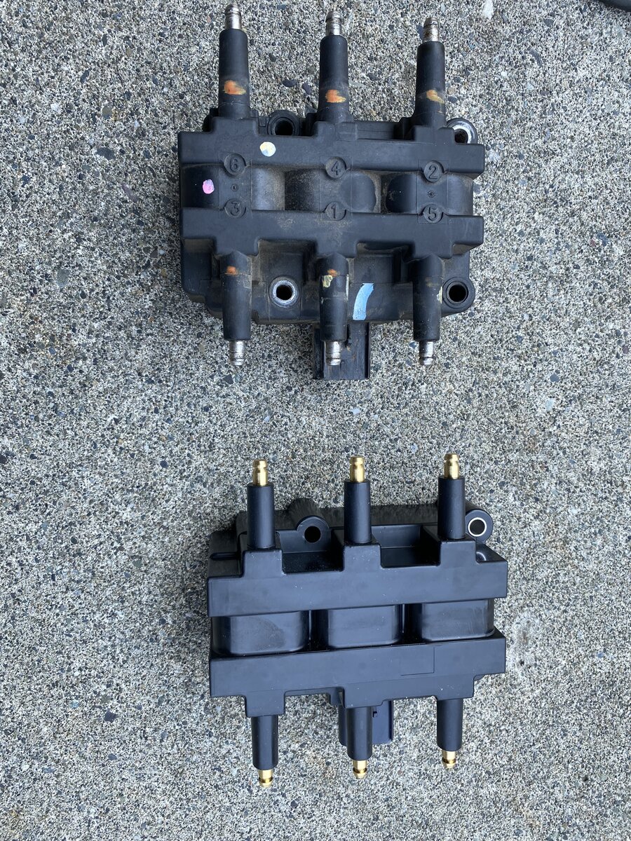

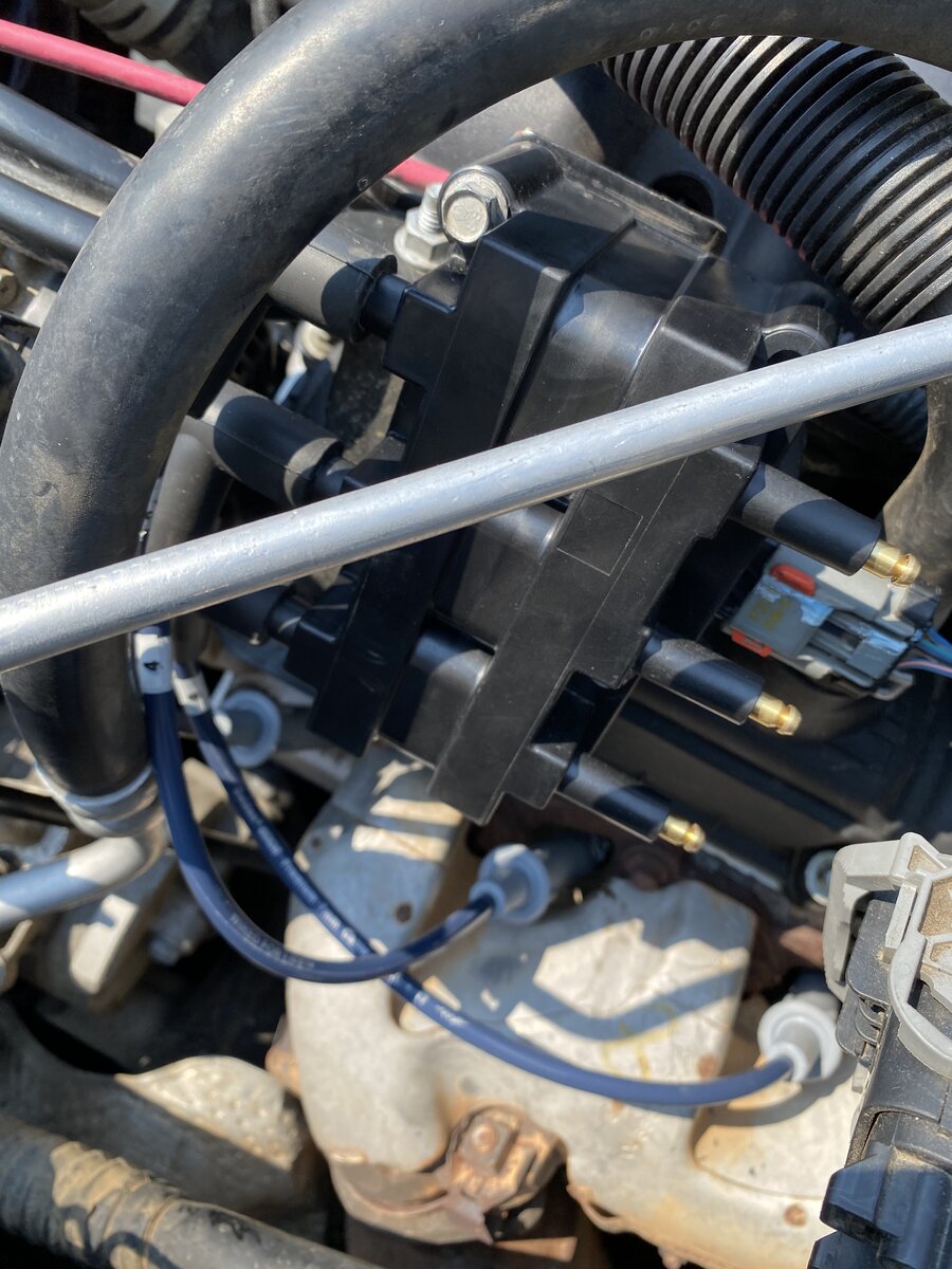

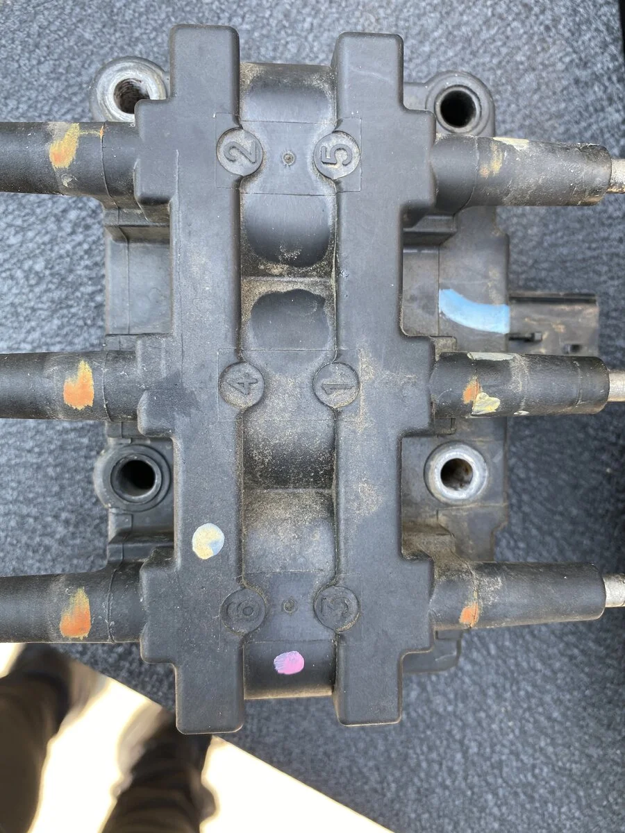

Disconnect the spark plug wires at the coil using a twisting motion as you pull the plug away from the terminal. Take note of which plug wire connects to the coil pack. You can use a sharpie to write the cylinder number on the plug wire boot. Notice the coil pack has the cylinder number embossed on the case.

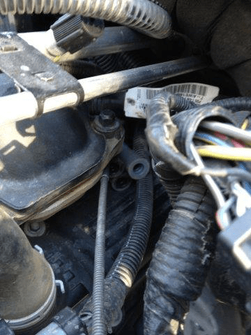

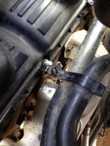

Disconnect the plug wires from the passenger side spark plugs and carefully lift up on the heater hose retaining bracket to release it from the valve cover stand-off bolt. (This will give you a bit more room to maneuver the wires during installation.) Remove the crankcase vent hose from the valve cover as well.

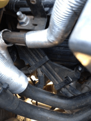

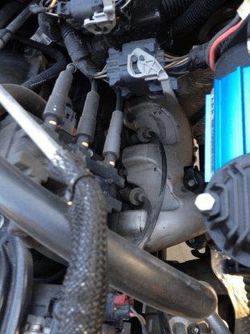

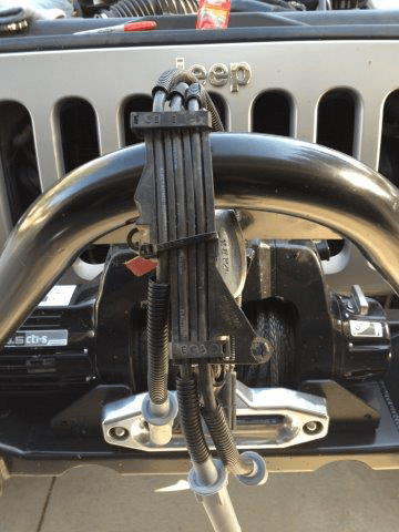

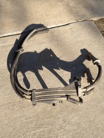

Carefully lift up on the spark plug wire tray to remove the retainer from the rear valve cover stand-off bolt. Gently pull the wire assembly towards the passenger side and down to work the wires from behind the engine until they are free. Pay attention to the routing of the wires from behind the engine during removal. You may have to push the wires from the driver side a bit to prevent them from hanging up on the engine. (Note: The wire tray is plastic and may break during removal due to being brittle from heat and age. Replacing it at this time might be a good idea.)
Remove and replace the passenger side spark plugs.

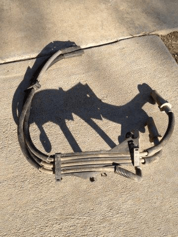

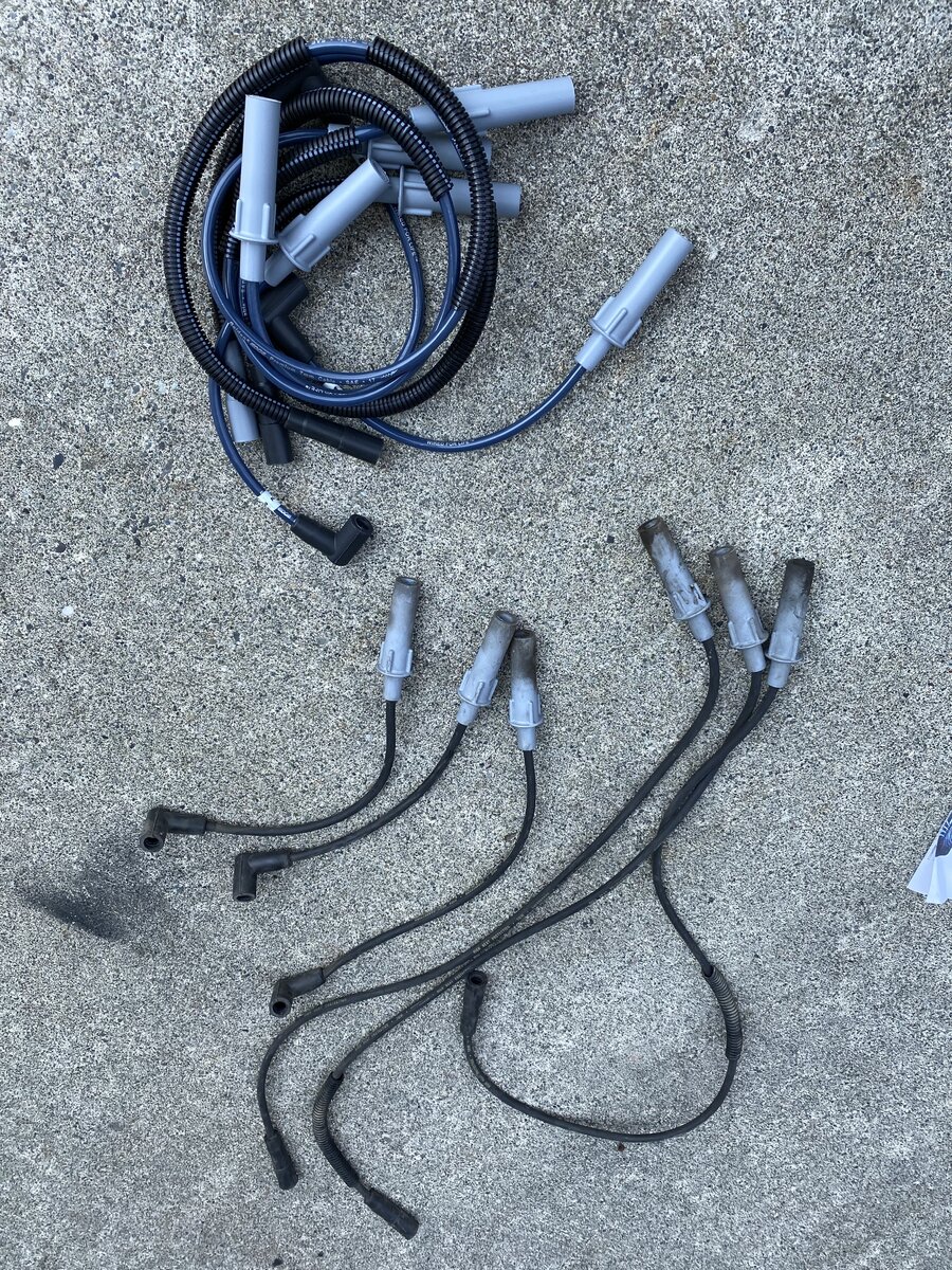

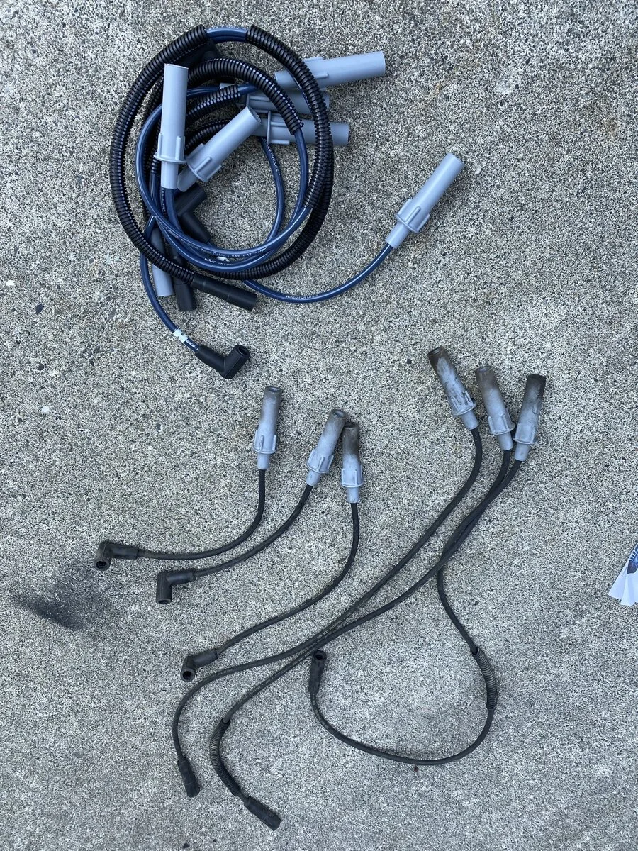

Carefully release the clips that hold the spark plug wires to the wire tray. Replace one wire at a time to maintain wire orientation and lengths until you have a complete assembly.

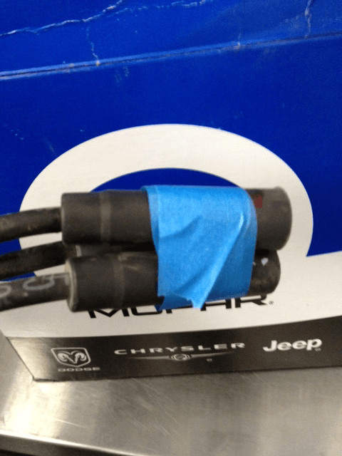

Using masking tape, wrap the plug wire ends that go to the coil terminals together. (This will help you route the wires behind the engine as an assembly.

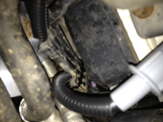

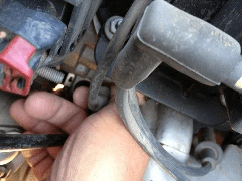

Route the taped end of the wires behind the rear of the passenger side valve cover from the top of the engine or, from under the wheel well if you removed the fender liner. Push the wires in behind the engine as far as you can until they are almost sticking out on the driver side of the engine. You may have to work the wires a bit to get them in the correct position. Then, using the mechanical fingers tool, grab one of the wire boots and pull it towards the driver side of the engine.

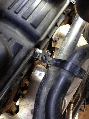

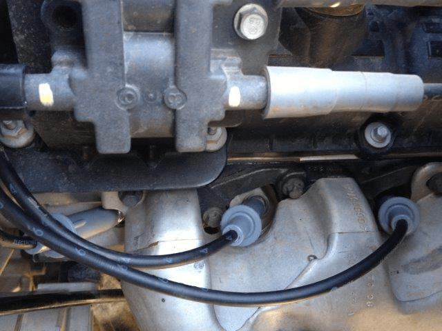

Reattach the wire tray to the valve cover stand-off bolt and reconnect the spark plug wires to the spark plug terminals. (See right side of picture)
Reattach the heater hose retainer to the valve cover stand-off bolt and install the crankcase breather hose.

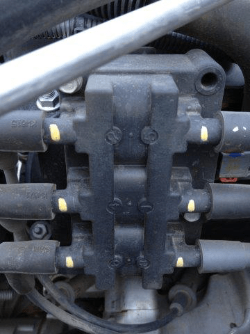

Connect the spark plug wires to the coil pack terminals in the correct cylinder order after adding a small amount of dielectric grease to the terminals.

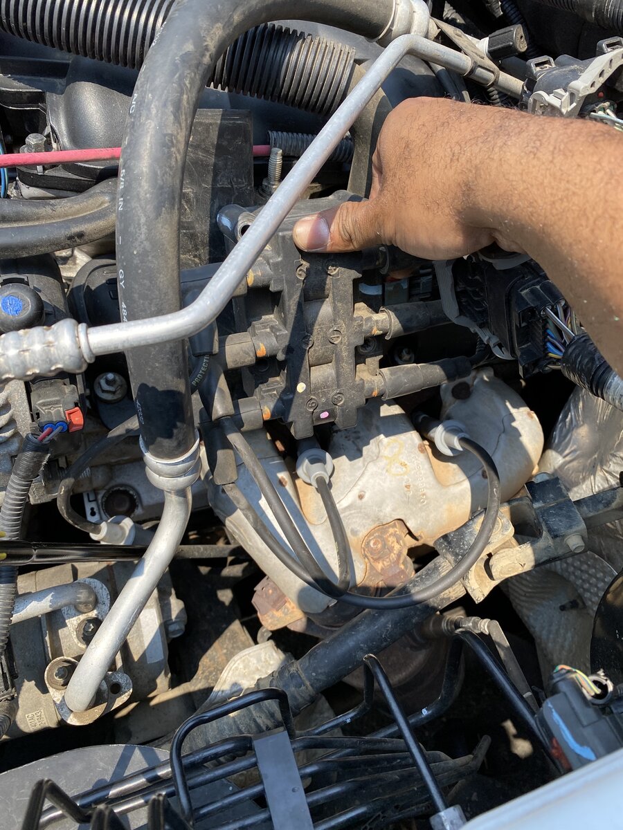

1. I almost took the fender off, but I wanted to challenge myself. Success. I just unpluged the air filter and heater hose to move them out of the way.
2. I used a 2" extension for the passenger side and a 12" extension for the driver side.
3. 45 min later, I got them swapped.
Damn.... idle is 50-75% smoother. Acceleration is smoother.

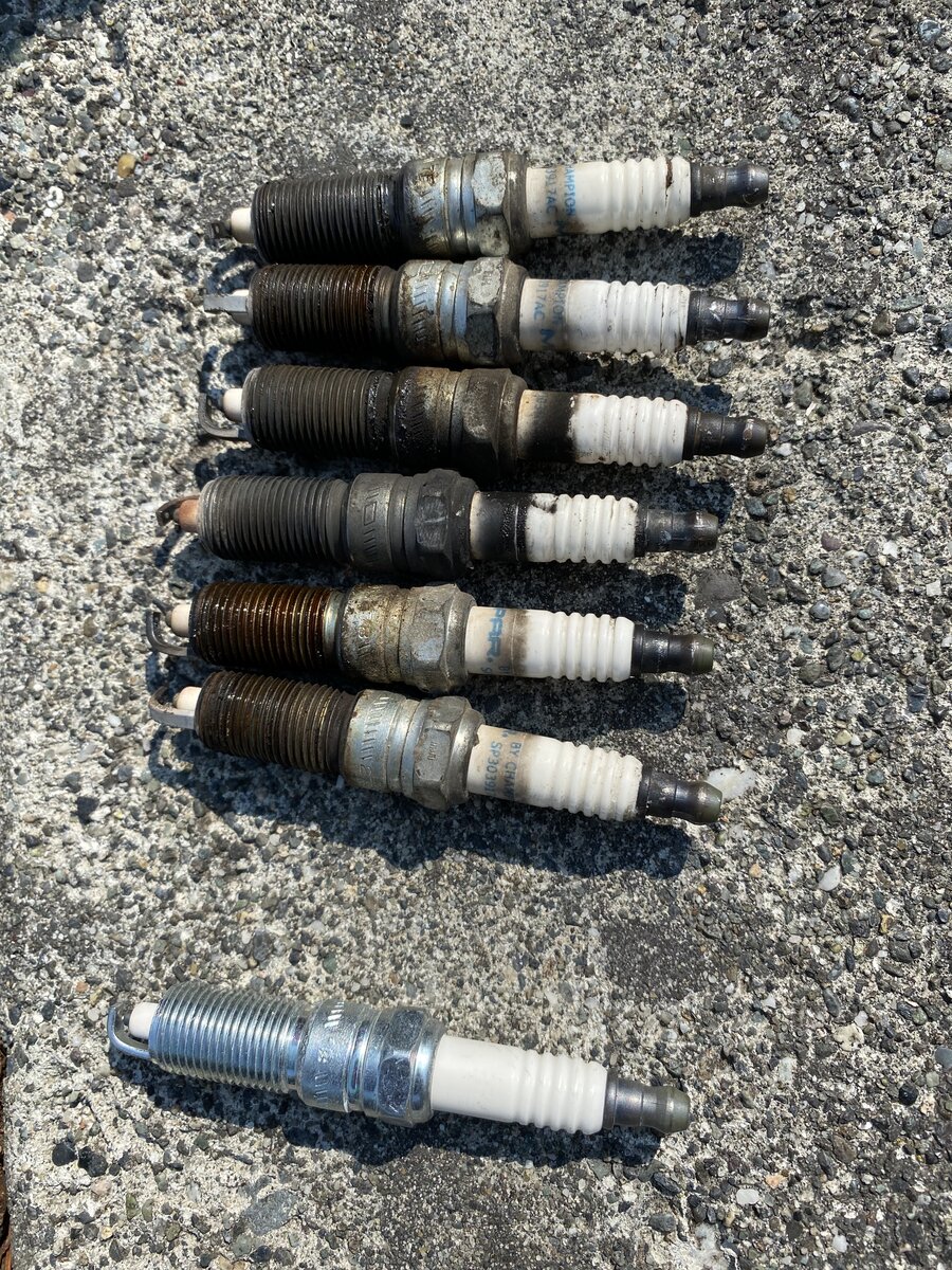

I don't think the PO changed the plugs at 100-102K miles like he/she should've. Here's a pic. If he changed them at 60k mi like some may do, would they look like this (see pic)? The gaps were estimated to range from .060 to .075. I only wonder, because the rest of the JK has been cosmetically and mechanically maintained.

I was wanting to put anti-seize, but this write-up is not the first time I've heard not to put them on these Champ double platinums. However, if it makes you feel better... mine appear to have been in there for 122,000 miles and change - AND they took minimal force to loosen them after I got those stubborn plug boots to come out, particularly 5 & 7, because I had no room to pull... all I can say is, keep trying (twisting, pulling and then make the face :)) But, taking the old plugs out (I can speak for the Champion 7440s) was easy as hell.
