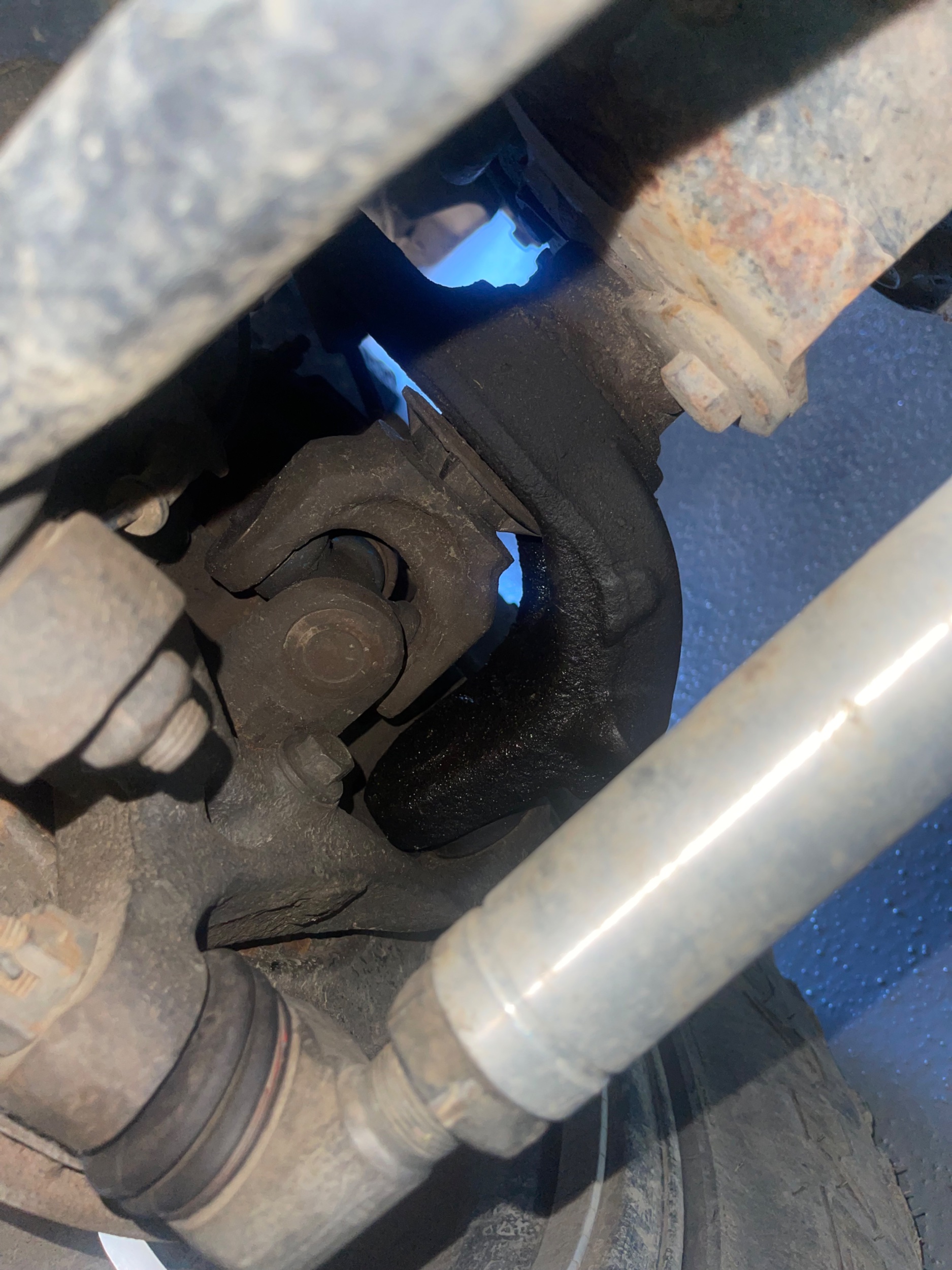

I saw about a week ago that there was a leak on my passenger side axle shaft on to the knuckle
It's the inner axle seal at the Center Section, in the mean time you should check to see if your gear oil is low so you don't cause bearing failure.

You can get all your axle seals replaced for around $400-600 (USD). With winter temp extremes headed your way, that leak will likely get worse as the seals shrink in the cold weather.
