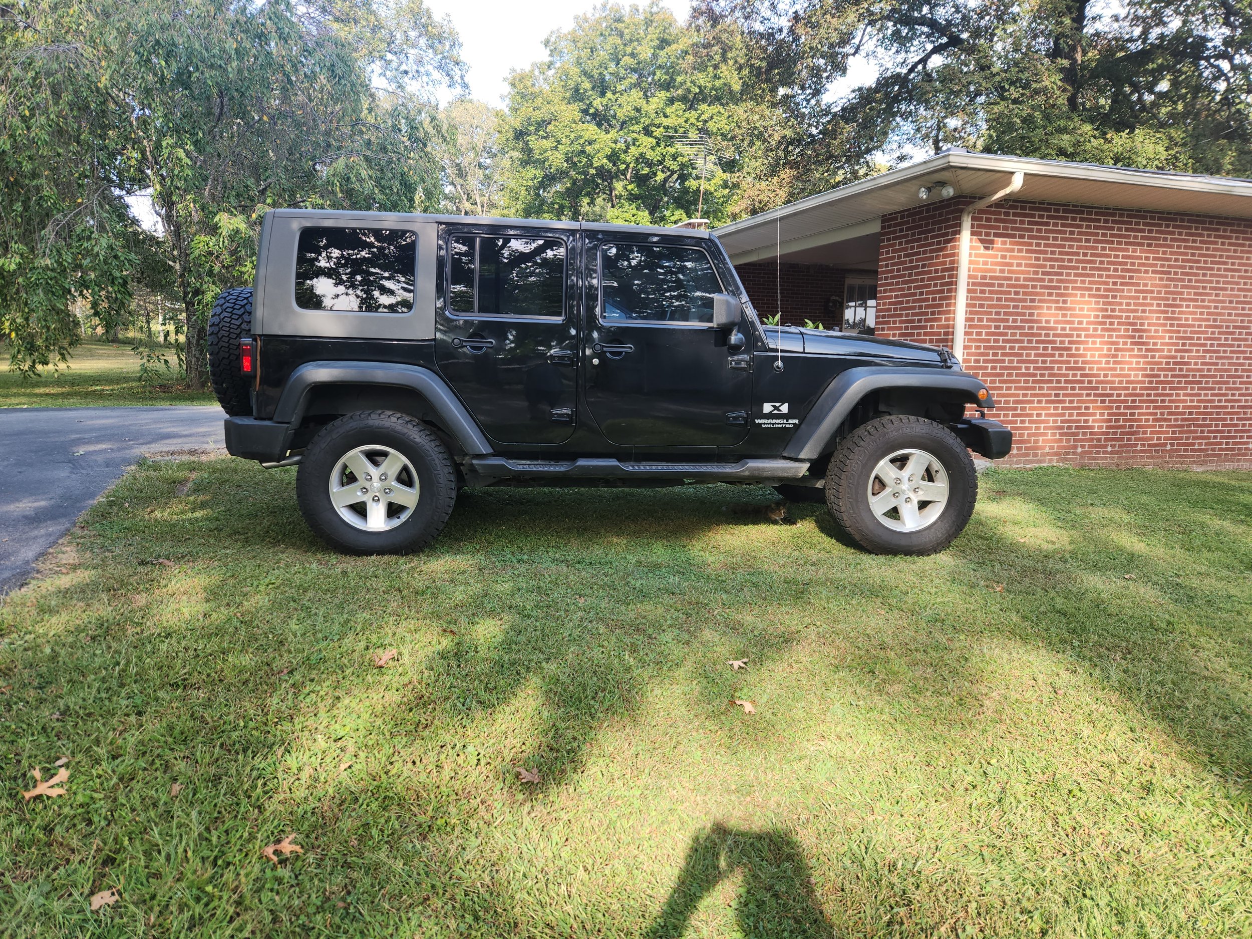

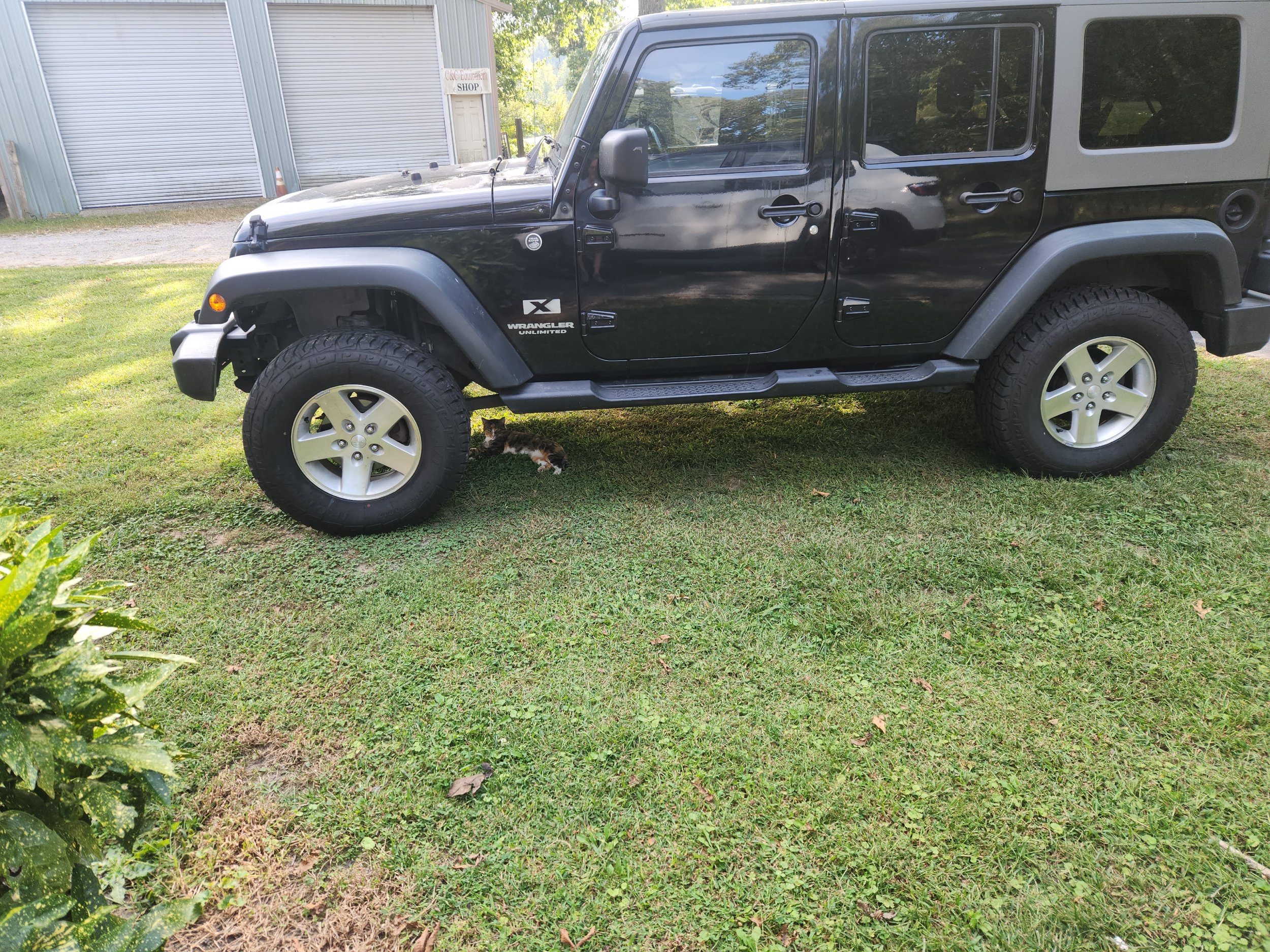

Ok got the wheels and got everything installed yesterday!!
They may rub off road, but they don't rub just running around.
