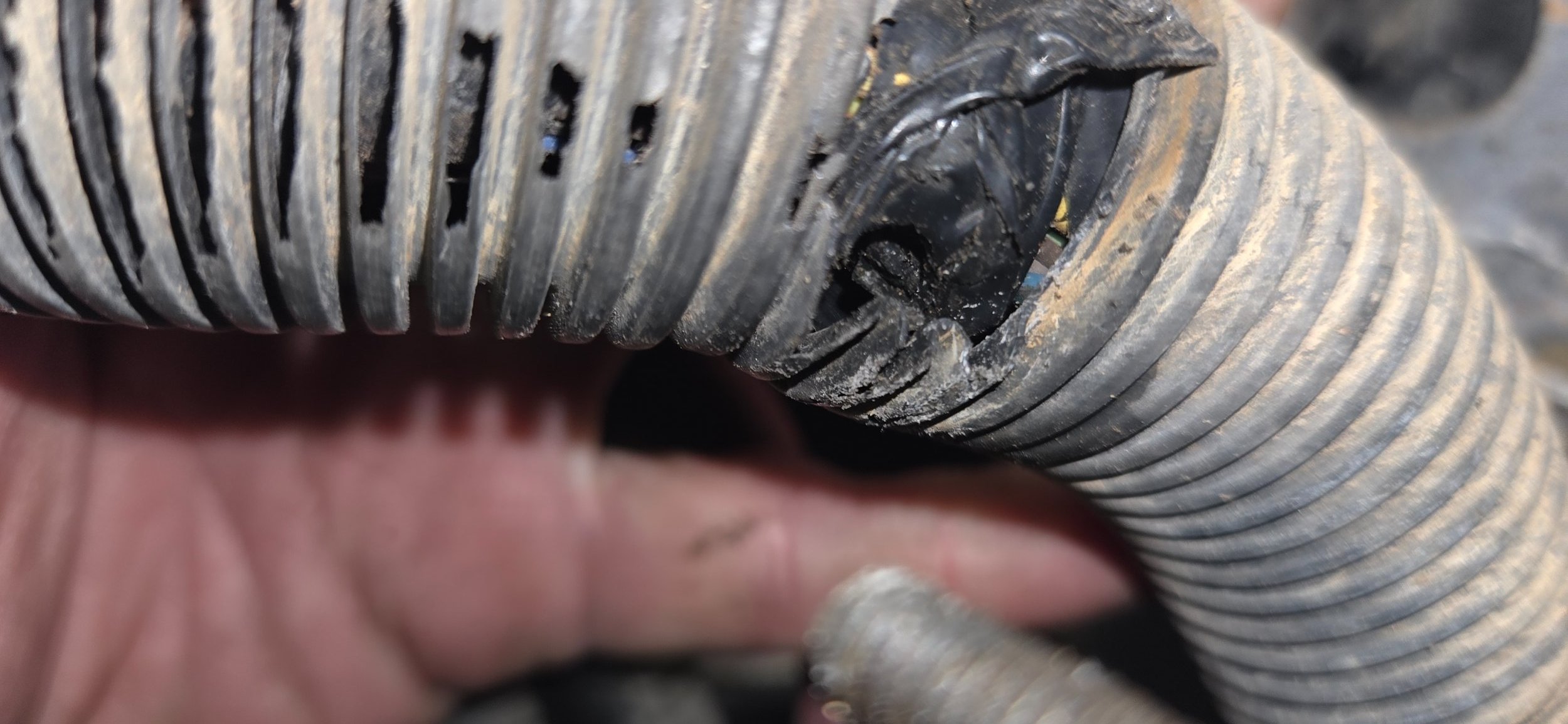

Marty123, so I finally figured out that we had a direct short on the harness that runs behind the engine and firewall. The clip that secures the harness to the firewall has broken allowing the harness to shift and rest on top of the back valve cover stud. Over time it had rubbed a hole in the wire loom wrap and eventually the wire. I've resecured it up and away from the contact point. It's currently running. If it gives me anymore trouble down the road it's going to be a job repairing the wire!
Now that I think of this it's a common problem with some of the Jeeps, a few others have had the same issue.
