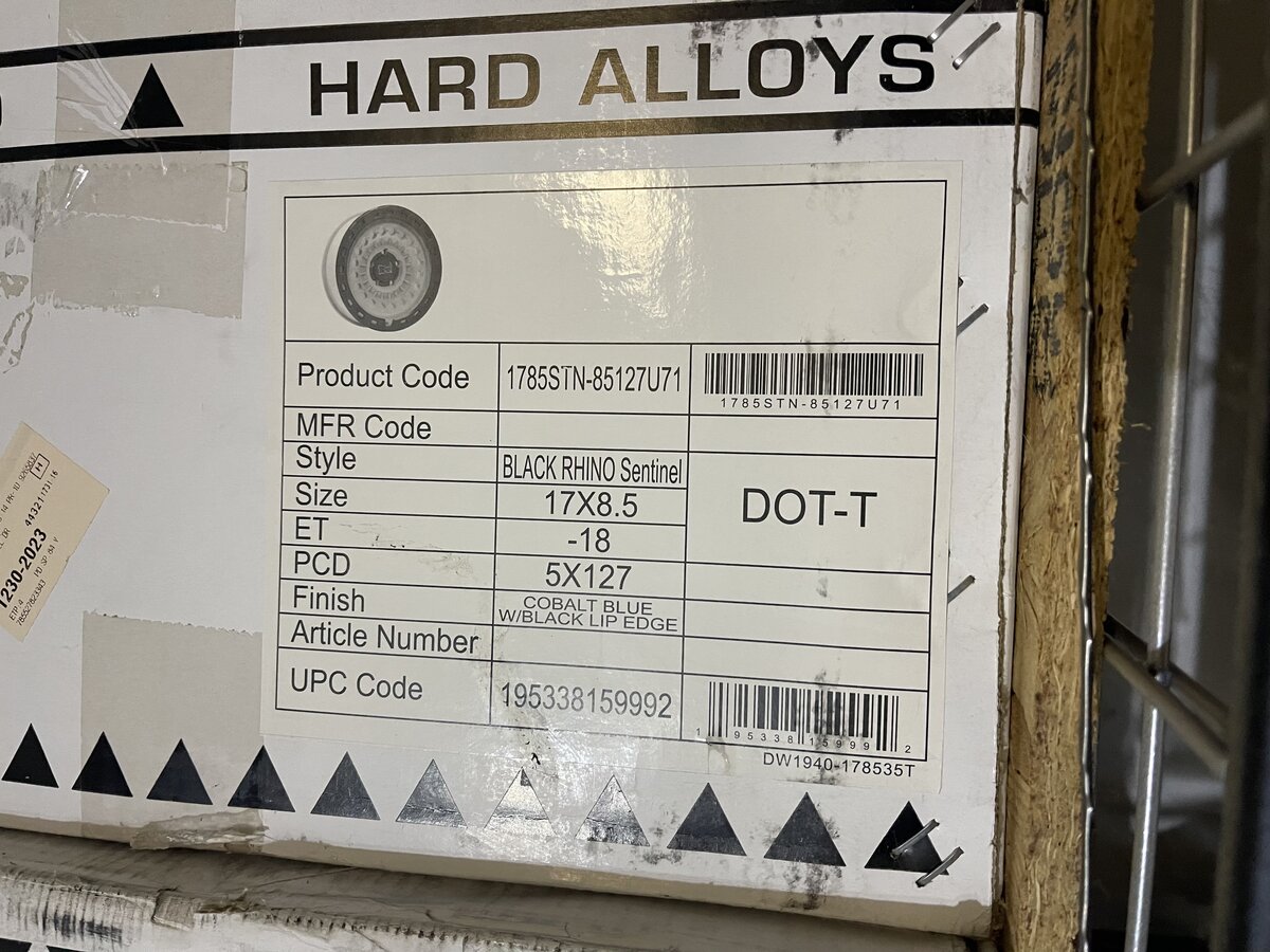

Hi!… I am new to this forum and I am not schooled on tire upgrades and what not… my current vehicle is a 2014 jeep wrangler unlimited sport.. The rims I have on there now are 17 x 8 1/2… The tires that are currently on there are 255/75R17…on the box The rims came in it says ET = -18 which I looked up I believe means the offset is 4.25… I will not be going off-road with this vehicle at all I am just “theming“ it… that being said..my question is can I put 285/70 tires on those rims and not have to get a lift or put spacers… I understand I might have to trim or take off that piece of plastic that’s just under the fender because of possible rubbing on that… I have been looking at different forums and I’m not sure if I will have to do something with the gears… I hope I’m asking this all the right way.. because if I have to do a lift or put spacers in or mess with the gears I won’t do it was just hoping I can put the larger tire on there and be done with it… any info would be great thanks for replying in advance! I attached a photo of the outside of the box the rims came in also

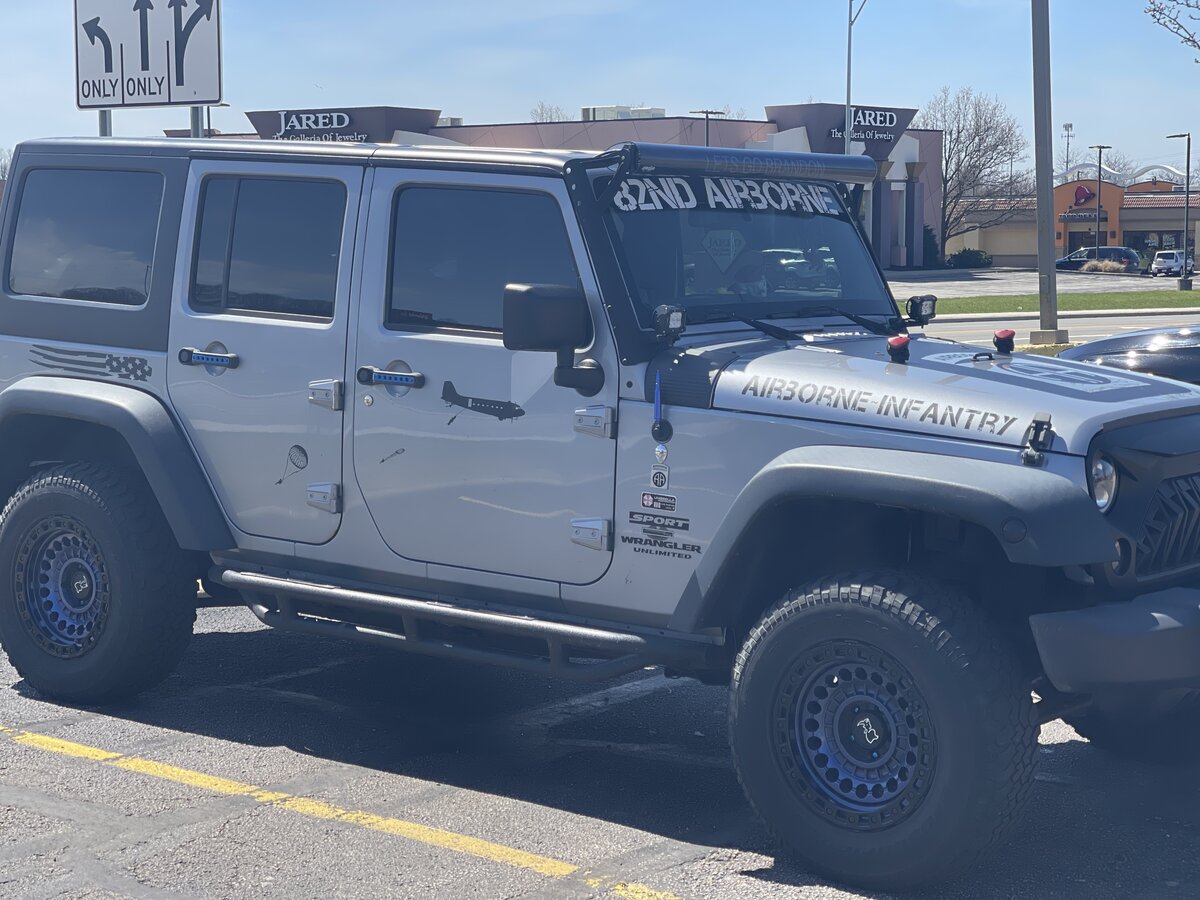

It looks as though you already have a lift of some sorts. You will have to recalibrate your speedometer and depending on what gears you have you might have to do a gear change.
I bought this Jeep in 2020 and all I have done is buy new rims and kept the tires because they were good.. The person who had it before had the stock rims and tires how can I tell if it’s been lifted?.. and how do I find out about the gears you were talking about?
OK thanks for the links I now found out that I have a 2 inch lift already on there and as far as the link to find out the gears I don’t necessarily know what to look for on that long list don’t know what verbiage to look for that being said if I already have a 2 inch lift couldn’t I technically put 285/70 on there?… with only having to adjust the speedometer and gears I would imagine they had to of done one of those possibly when they did the lift because it’s still had the stock tire and rim on there when I got it

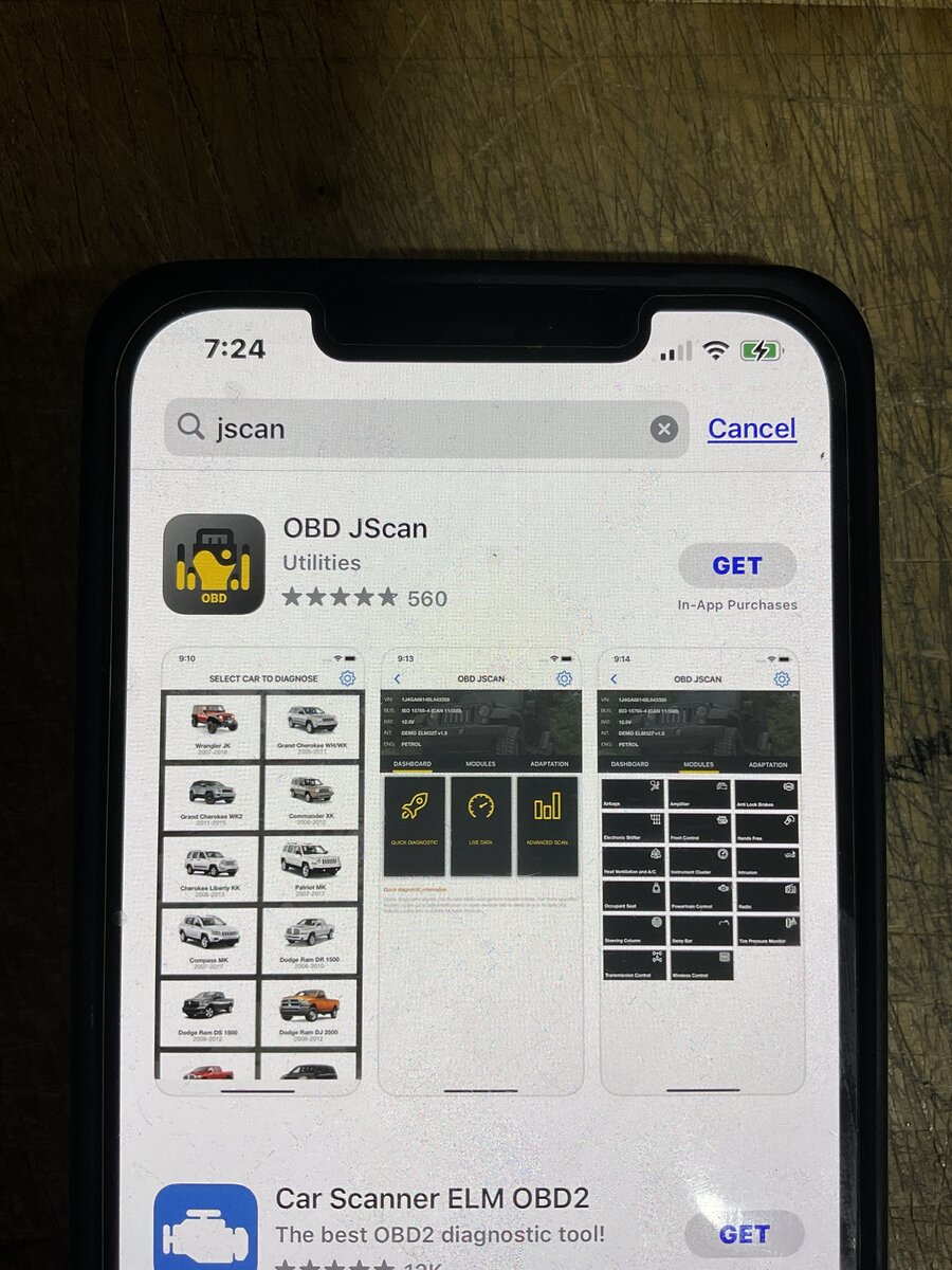

With the bigger tires you're going to get slightly lower gas mileage and it will feel ever so sluggish up hills. Get the Jscan app and a dongel. I used iCar Pro with Jscan. This helped recalibrate my speedometer and shift points which helped my Jeep feel more stock.
Is that the app you’re talking about do I need the icar pro also?
